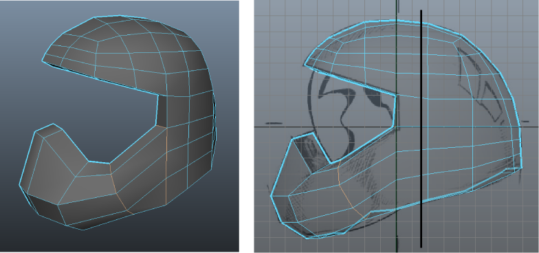

To combine the two meshes into one
  1. In the perspective view, right-click the mesh and select Object Mode from the marking menu that appears.
  2. Select the helmet mesh, and then Shift-select the lower front mesh, so both meshes are selected.
  3. Select Combine in the Modeling Toolkit.
    The two meshes are combined into one. When you select either object now, the other is also selected because they are in the same mesh.

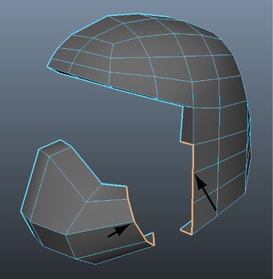

The edge of the mesh on the lower front region of the helmet is comprised of five edges. The corresponding region on the side region of the helmet only has three. You can increase the number of edges on the lower side region by inserting two edge loops across the mesh. Inserting two edge loops in this region of the mesh also divides the large faces so they better match the size of the other faces on the rest of the mesh.

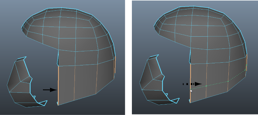

To insert edge loops on the side region of the helmet
  1. Select Mesh Tools > Insert Edge Loop Tool > .
    The Insert Edge Loop Tool settings editor appears.
  2. In the tool settings editor, set Maintain Position to Relative distance from edge.
  3. In the perspective view, click-drag the edge on the side region of the helmet near the bottom of the edge as indicated in the image below. Without releasing the mouse button, drag the mouse upwards about one third of the distance along the edge and then release the mouse button to insert the edge loop.

    Click-dragging an edge when using the Relative option inserts an edge loop that closely matches the existing edge layout on the mesh. That is, the lower region of the mesh is much wider near the front than at the rear. The Relative setting adjusts the position of the edge loop locator based on this topology so is ideal in these situations. When you click-drag using the Relative option, remember to click near the edge whose layout you want the edge loop to match.

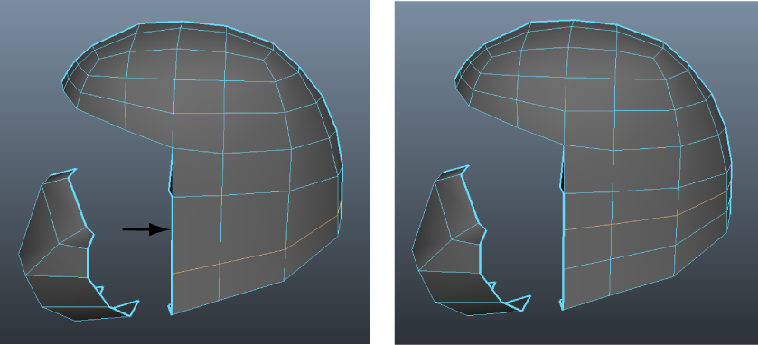

  4. With the Insert Edge Loop Tool still active, click-drag the side region of the helmet near the top of the same edge and insert a second edge loop about two thirds of the distance along the edge.
  5. Press the q key to return to selection mode, and click anywhere off the mesh to unselect the edges.
    Now that you’ve inserted the necessary edges, you can proceed with creating the bridge.
To bridge between the lower front and side region of the helmet
  1. Select the top edge of the lower front, and then Shift + Double-click on the lowest edge on the front as well as the side region of the mesh where you want the bridging mesh to be constructed. (You should have five edges selected on either side).
