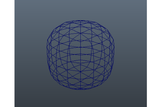

To smooth and subdivide the cube primitive
  1. With the cube still selected in the scene view, go to the Modeling Toolkit and Shift + Left-click Smooth, and set the following options in the window that appears:
    • Add divisions: Exponentially
    • Division levels: 2
  2. Click Smooth.
    The cube primitive is smoothed and is rounded at its corners. The cube has also been subdivided into smaller faces.
    The polygon faces are still four-sided even though their shape and position have been modified by the smooth operation.

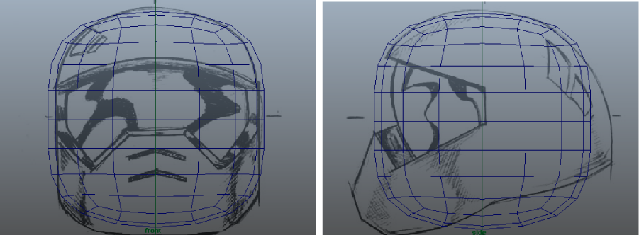

    Note:
    If the top, domed portion of the smoothed cube doesn’t roughly match the helmet sketches as indicated in the image below, scale both images with the Scale Tool to make it match. Do not scale the cube, as later steps will provide numbers based on the cube's current size.
