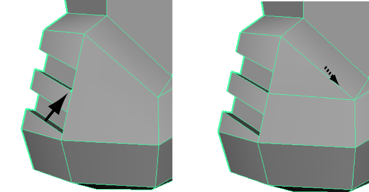

  2. In the perspective view, click-drag on the top side edge of the grill vent. Drag your mouse so the vertex is positioned at the bottom of the edge (see image).
  3. Click-drag on the top edge of the multi-sided polygon and slide the vertex to the right end of the edge (see image).
  4. Press the y key to split the face.
    The region above the split edge appears like it has three-sides but is actually four-sided because of the edges on the grill vent.

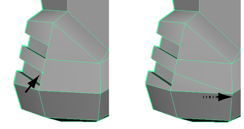

  5. Split the side edge on the bottom grill vent in a similar fashion by click-dragging your mouse so the vertex is positioned at the top of the edge (see image below).
  6. Click-drag the bottom edge of the multi-sided polygon and slide the vertex to the right end of the edge (see image).
  7. Press the y key to split the face.
