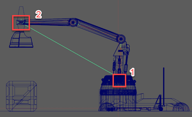

  3. Working in the side view, starting from the base of the mechanical arm, do the following:
    • Click on the skeleton joint at the base of the mechanical arm.
    • Click on the skeleton joint at the tip of the mechanical arm. (The IK Tool is designed to attach to the joints closest to your selection point.)
    In the side view, the IK handle is drawn as a line from the start and end joints of the IK chain.

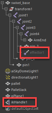

  4. In the Outliner, two new nodes appear in the hierarchy that represent the IK chain: an IK Handle node and an end effector node.
  5. In the Outliner, select the node named ikHandle1.
    The IK Handle (in combination with the end effector) is used by the IK solver to calculate the rotation of the joints in the IK chain. By default, the IK Handle is located at the last joint of the IK chain in the scene view.
