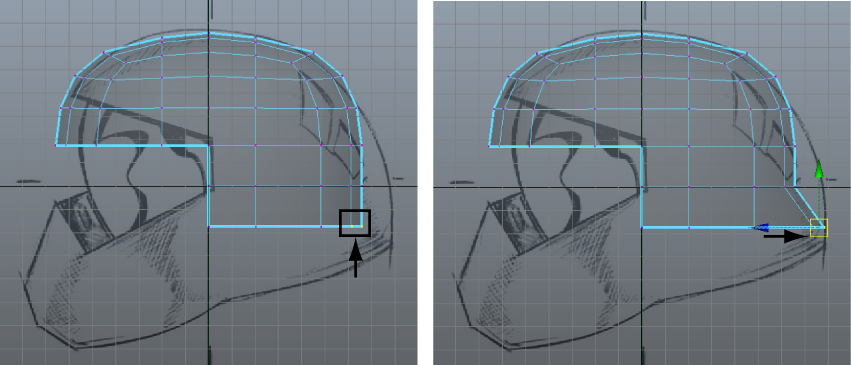

To manually reposition the vertices on the rear of the helmet
  1. In the side view, right-click the helmet and select Vertex from the marking menu that appears.
  2. Select the pair of vertices at the rear lower edge (see image) by dragging a bounding box around them.
  3. In the Toolbox, click the Move Tool.
  4. In the side view, click-drag the blue arrow on the Move Tool manipulator towards the right until the vertices are repositioned so that your helmet matches the reference sketch on the image plane.
    By moving the vertex as well as the vertex adjacent to it along the axis of symmetry, you ensure that the symmetrical shape of the helmet is maintained. If you move one vertex independently of the other it may result in an unwanted bump or valley in the mesh. These types of anomalies will become more apparent when you copy the completed half of the mesh across the axis of symmetry.

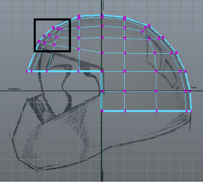

  5. Repeat steps 2 through 4 for the other pairs of vertices on the rear of the helmet. Ensure that the edge loops appear smooth in relation to each other.
    When you have finished, the back region of the helmet should closely match the reference image on your image plane.
  6. In the side view, select other pairs of vertices along the top and front of the helmet and move them in a similar fashion so they match the reference image. Do not reposition the vertices for the top of the face shield yet.

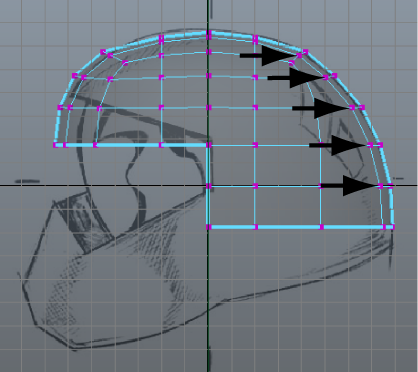

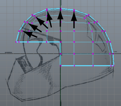

  7. Move the vertices in the front half of the helmet above the face shield upward.

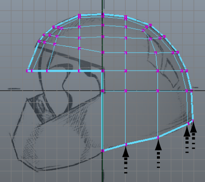

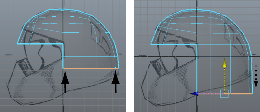

To reposition the lower border edges on the helmet
  1. In the side view, select the first edge of the border, then hold Shift + double-click the last edge of the border as indicated in the image below.
  2. Using the Move Tool, drag the selected edge loop downwards until the left hand vertex roughly matches the lower edge indicated in the reference sketch.
  3. In the side view, select and reposition the remaining vertices individually on the edge loop using the Move Tool so they match the reference sketch.

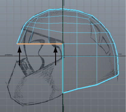

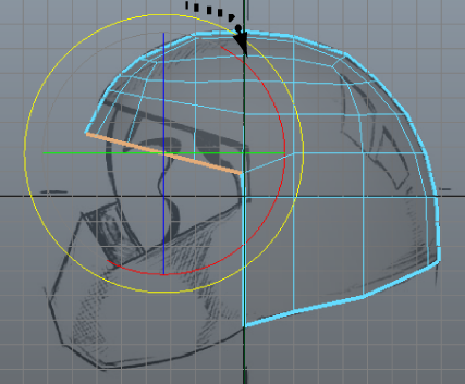

To edit the border edges on the upper edge of the face shield

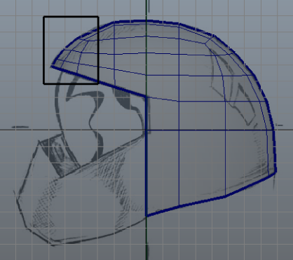

  1. In the side view, click the first border edge that will be used as the upper edge of the face shield, then hold Shift + double-click the last border edge (see image).
    The border edges in between are selected.
  2. In the Toolbox, select the Rotate Tool by clicking its icon.
  3. In the side view, click-drag the rotate manipulator in a clockwise direction until the border edges are rotated at roughly the same angle as the corresponding edge in the reference sketch.

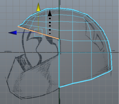

  4. With the border edges still selected, click the Move Tool again and drag the green manipulator upwards to match the location of the border edges in the reference sketch.
    Note: You may need to move the position of vertices in the upper part of the helmet before you move the border edges.
  5. Reposition the pairs of vertices on the upper front of the helmet to match the reference sketch.

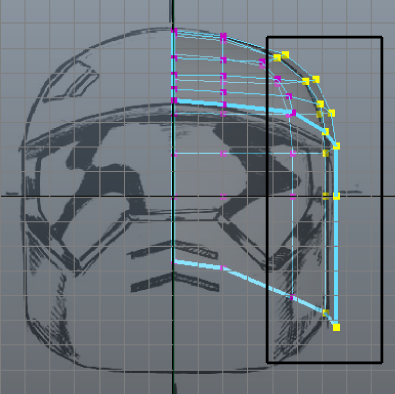

To reposition vertices on the side of the helmet to match the sketch

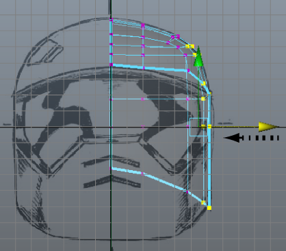

  1. Display the front view.
  2. Right-click the mesh and select Vertex from the marking menu that appears.
  3. In the front view, select the vertices that extend beyond the outline of the helmet as shown in the reference sketch (see image).
  4. In the front view, move these vertices to the left until they match the widest area of the helmet in the reference sketch (see image).

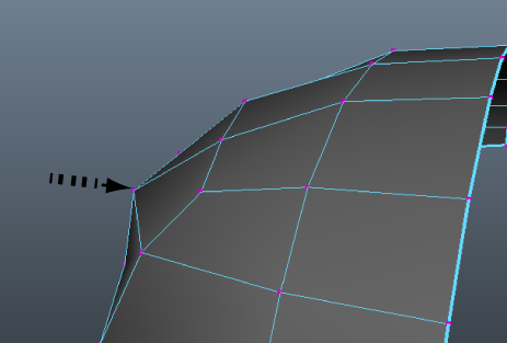

As you examine the vertices along any particular edge loop, the vertices on the mesh should appear to cascade in a smooth gradual fashion to create the curvature of the mesh with no undesirable spikes or dips.
Ensuring that the mesh appears relatively smooth at various stages throughout the modeling process will reduce the possibility for issues when you create a high resolution version of the mesh later on.
If you find areas where one vertex (or more) appears to protrude outwards (or recedes) on the mesh in relation to neighboring vertices, you can correct these protruding regions by repositioning the affected vertices in the perspective view.
