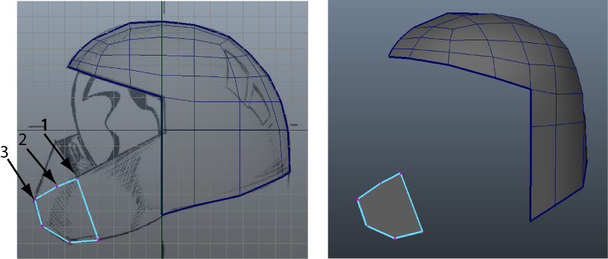

To create the lower front region of the helmet (that is, the region that would protect the mouth and jaw of the wearer) you’ll create a polygon for the cross section of the lower front region by manually placing vertices using Create Polygon.
To place vertices for a polygon
  1. In the side view, select Mesh Tools > Create Polygon > .
    The Create Polygon settings editor appears.
  2. In the tool settings editor, set the following options:
    • Limit the number of points: On
    • Limit points to: 6
    These settings specify that a closed polygon face will be created once you have placed six vertices in the scene.
  3. In the side view, place six points for the profile in the lower front region of the helmet (see image below).
    Important: Ensure that you place the vertices in a counter-clockwise direction for this step.
    The new polygon face is created along the YZ plane (the axis of symmetry for the model).
  4. Press the q key to quit Create Polygon when the polygon face is complete.
    The new polygon component remains selected in Object Mode.
