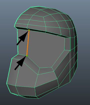

To split the face shield vertically
  1. Select the helmet mesh.
  2. In the Modeling Toolkit, select Multi-Cut.
  3. Tumble the camera in the perspective view so you can view both the upper inner edges of the face shield as well as the lower inner edges.

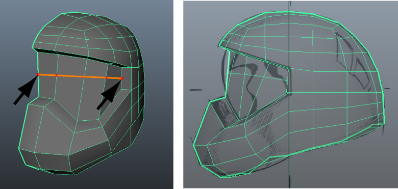

  4. Click the top inner edge of the face shield to indicate the start of the split (see image below).
  5. Click on the lower inner edge of the helmet mesh to indicate the end of the split (see image).
  6. Press the y key to split the face.
  7. Continue to split the face shield vertically at the other locations specified in the image below. Remember to press the y key after each split.

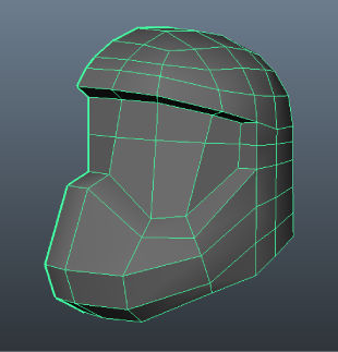

    When you are finished the n-gon for the face shield will be split into four new polygons.

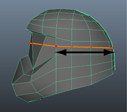

To split the face shield horizontally
  1. In the perspective view, with the Multi-Cut Tool still active, click the inner side edge (see image) to indicate the start location for the horizontal split.
  2. In the side view, click the front vertical border edge of the face shield (this border edge lies on the axis of symmetry) and release the mouse button at the mid-point along the edge where the vertex naturally snaps (as if a magnet were attracting it towards that location).
  3. In the perspective view, rotate the helmet and click its back vertical border.
  4. Press the y key to split the faces.

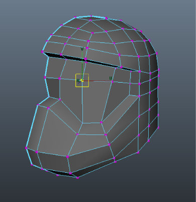

To adjust the shape of the face shield

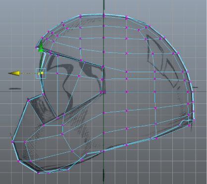

  1. In the side view, select the middle two vertices at the front of the face shield and use the Move Tool to move the vertices outwards (+Z) a small amount (see image).
  2. In the perspective view, select the remaining middle vertices on the face shield one at a time and reposition them outwards a small distance using the Move Tool with the Move Setting option set to Normal.

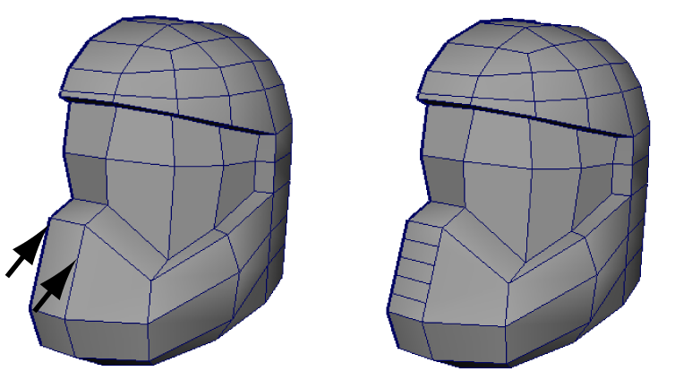

  3. In the perspective view, click the border edge of the face where the grill vents will appear and then click the edge directly opposite that border edge (see image).
  4. Press the y key to complete the edge loop insertion

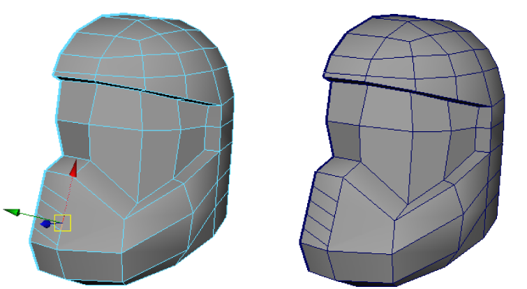

To make the grill vents appear diagonally you’ll select the vertices on the right side and then slide them downwards using the Move Tool.
To move vertices along an edge using the Move Tool
  1. Right-click the helmet mesh and change the selection mode to Vertex.

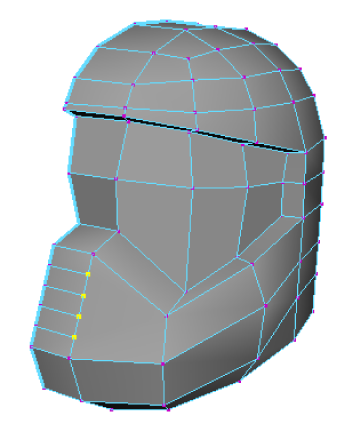

  2. Select the vertices on the right side of the grill feature (see image below).
  3. Double-click the Move Tool icon to display the Move Tool’s settings editor.
  4. In the Move Tools’ settings editor, set Axis Orientation to Custom, and then in the drop-down menu below, select Set To Edge.
    The vertices appear unselected temporarily. The Move Tool expects you to select an edge it will reference for the axis of movement.
  5. Click an edge that is directly connected to and above or below the vertices you selected.
    The Move Tool manipulator appears and is aligned to the edge you selected. The vertices appear selected again indicating that the Move Tool is now set to move those vertices along the axis defined by the edge you selected.
  6. Drag the red arrow on the Move manipulator downwards to move the vertices so that the shape of the faces for the grill are more diagonal (see image).
    Note:
    Make sure you do not move the vertices so that the lowest vertex touches the corner vertices or you’ll create an edge that has zero length.
  7. Click off the mesh to deselect the vertices.
  8. Before proceeding to the next section, double-click the Move Tool and reset the tool settings by clicking the Reset Tool button.

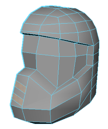

To make the grill vents three-dimensional, you’ll extrude some of the thin diagonal faces inwards.
To extrude the faces for the grill feature
  1. Right-click the helmet mesh and change the selection mode to Face.

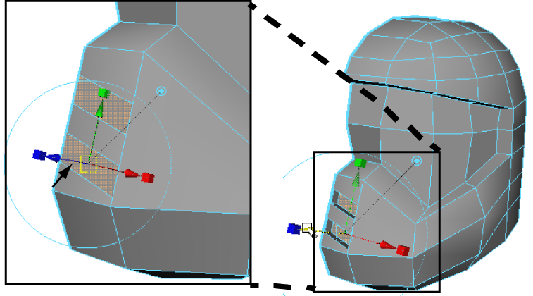

  2. Beginning at the bottom of the grill feature, shift-select the two diagonal faces as indicated in the image below.
  3. Select Extrude from the Modeling Toolkit.
    The Extrude manipulator appears.
  4. Drag the blue arrow on the Extrude manipulator towards the helmet a short distance to create the two recessed vents for the grill.
  5. Press the q key to quit the Extrude feature.

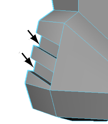

  6. Shift-select the two side faces on the grill vents that lie on the axis of symmetry and delete them (see image below). These faces will not be required when you create the opposite half of the helmet.
