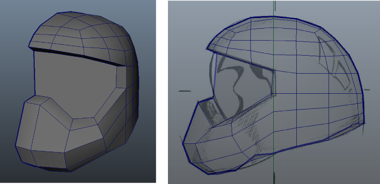

Adding polygons to a mesh
For the protective face shield on the helmet, you'll create one large multi-sided polygon using the Append to Polygon Tool and then split it into multiple four-sided polygons (quads) so that the new polygons match the existing four-sided topology of the helmet mesh.

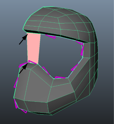

  4. In the perspective view, click once on the top inner border edge of the helmet mesh to indicate which mesh you are appending to, and then click the same edge a second time to begin the append operation (see image below).
  5. Click the bottom edge of the face shield that is opposite the first edge you just clicked.
    A polygon appears that spans the two edges.

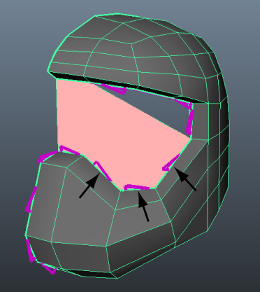

  6. Continue to click the remaining border edges in a counter-clockwise direction around the opening for the face shield until you reach the last edge.
  7. When you are finished clicking the perimeter border edges for the face shield, press the q key to quit the tool.
    The multi-sided polygon is completed and added to the existing mesh. Multi-sided polygons are also referred to as n-gons.
