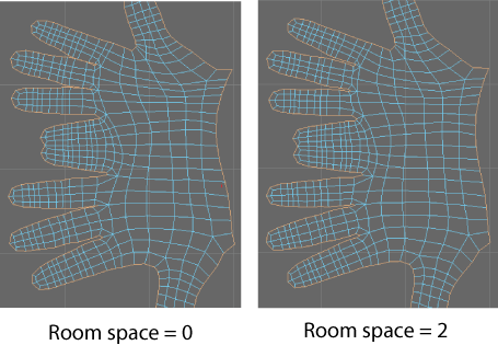

When Room space is greater than 0, it prevents textures from bleeding past the UV borders. Avoid increasing this value past its default (2 pixels), because it can slow down the unfold calculations and create distortion.
