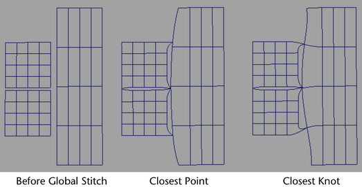

The Stitch Corners options specify where a surface corner is stitched to an adjacent corner or surface edge. Regardless of which option you choose, stitching occurs only if the points are within the Max Separation distance.
Stitching occurs at a point between two corners or between a corner and a point on the surface edge. Where a corner would stitch to a point on an edge rather than a corner, the following options are available.
stitches a corner to the closest point on the edge.
stitches a corner to the closest knot on the edge.
does no explicit corner stitching.

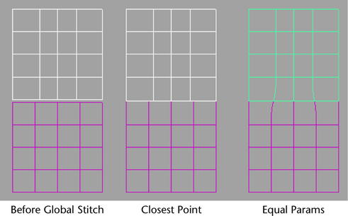

The Stitch Edges options specify where adjacent edges are stitched together. Regardless of which option you choose, stitching occurs only if the edges are within the Max Separation distance. Stitching occurs along the midpoint between the edges.
stitches the closest points on the edges while ignoring parameterization differences between the edges. Because the number of patches may differ, an exact join might not occur.
stitches points on the surface edges that have equivalent UV increments along each edge. The number of spans is ignored. To achieve the best possible fit with this type of stitching, make sure the two edges have the same UV values, the same number of spans, and lined-up knots.
does no explicit edge stitching. If you turn on one of the Stitch Corners options (other than Off) and set Stitch Edges to Off, the corners will be stitched together, but not the edges.

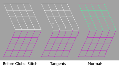

Select the way that the joined isoparms appear.
bends isoparms so they are perpendicular where they meet the stitched edge. This yields the best continuity between the surfaces.
does not require the isoparms to be perpendicular, though the surfaces still join smoothly.
turns off smoothing and doesn’t ensure tangency of the edge regions.
You can use Stitch Corners, Stitch Edges, and Stitch Smoothness in any combination to create a variety of stitching results. If Stitch Smoothness is Off but one of the Stitch Edges options is on, the edges will touch, but the stitched region between the edges might not be smooth.

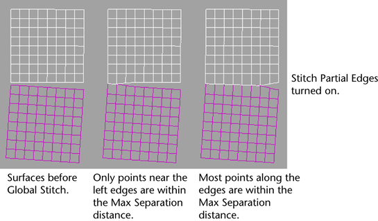

If this option is on, Maya joins any parts of an edge pair that are within the Max Separation distance. The same pair of edges may therefore join and separate a number of times along their length. If this option is off, no part of the edge pair will be stitched if any points along the edges exceed the Max Separation distance.
Do not turn on Stitch Partial Edges when unnecessary. This option takes extra processing time.
