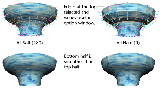

You can modify the shading of individual polygons by manually editing the vertex normals associated with the polygon mesh.
| To... | Do this |
Show vertex normals. |
Select the mesh and select Display > Polygons > Vertex Normals. |
Make selected edges appear sharp in shaded mode. |
Select Mesh Display > Harden Edge. |
Make selected edges appear soft in shaded mode. |
Select Mesh Display > Soften Edge. |
Harden selected edges by angle or texture border |
Select
Mesh Display > Soften / Harden Edges >
Lock or unlock vertex normals to their current direction. |
Select the vertices and choose Mesh Display > Lock Normals or Mesh Display > Unlock Normals. |
Force normals to point along a certain vector (by entering values numerically). |
Select the locked vertices and select
Mesh Display > Set Vertex Normal >
Turn off both Lock Normals and Unlock Normals. Use the text boxes to enter the X, Y, and Z rotation values for the vector, then click Set Normal. |
Force normals to point along a certain vector (by adjusting a manipulator) |
Select the vertices and choose Mesh Display > Vertex Normal Edit Tool. Use the manipulator to adjust the direction of the normals. |
