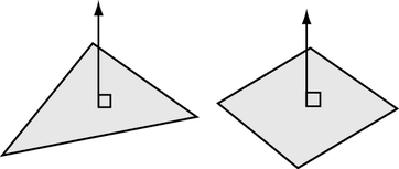

A normal is a theoretical line, perpendicular to the surface of a polygon. In Maya, normals are used to determine the orientation of a polygon face (face normals), or how the edges of faces will visually appear in relation to each other when shaded (vertex normals).
The front of a polygon’s face is graphically represented using a vector called the polygon’s normal.

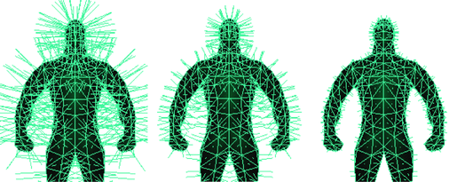

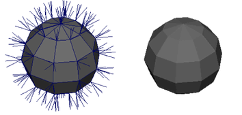

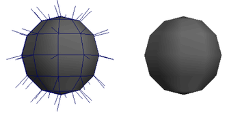

Vertex normals determine the visual softness or hardness between polygon faces. Unlike face normals, they are not intrinsic to the polygon, but rather reflect how Maya renders the polygons in smooth shaded mode.
Vertex normals appear as lines projecting from the vertex, one for each face that shares the vertex.
Manipulating vertex normals is the easiest way to soften or harden the appearance of edges (creases) without using additional geometry. You can do this automatically by using the Soften / Harden Edge commands, or by manually manipulating the vertex normals using the Vertex Normal Edit Tool (Mesh Display > Vertex Normal Edit Tool). When the vertex normals for a polygon mesh are manually edited they become locked or frozen. When you unlock a previously locked vertex normal, Maya automatically recalculates the vertex normal for the face based on its default normal calculations.
