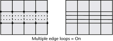

Inserts multiple equally spaced edge loops along the selected edges, based on the number specified in the Number of loops setting. The multiple edge loops cannot be manually repositioned. The maintain distance settings are not available when Multiple edge loops is turned on.

Specifies the number of edge loops to be created when the Multiple edge loops setting is on. The default setting is 2. When Number of loops is set to 1, a single edge loop is inserted at the halfway point between the edges.
