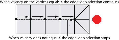

In Maya, an edge loop must meet the following criteria:
If you perform a double-click selection and two paths of selected edges appear unexpectedly, this usually indicates that the configuration of the four-sided polygons has one or more faces that are shaped in a diagonal fashion. As a result, the edge selection will deviate by continuing in a different direction. One example of this is when two locator lines appear on a single mesh to indicate that the selection has resulted in a U-shaped selection on the polygon mesh (see diagram below).

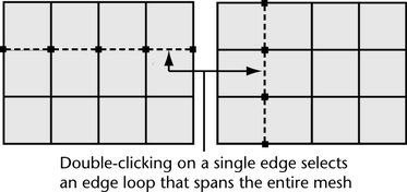

To select an edge loop on a polygonal mesh
When you double-click an edge on the mesh, a path of selected edges appears across the mesh in either direction from the edge you select.
For example, if you double-click on a single horizontal edge on a sphere, a loop selection will select the remaining edges that lie along the same line of latitude on the sphere as the edge you selected, provided the selection does not encounter any faces that are not four-sided.
