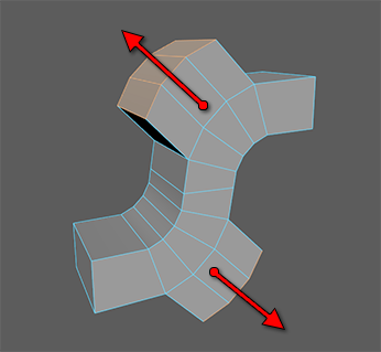

Moving one or several components on a polygon along the direction of their normals is a convenient, easy to manage method of editing a polygon surface.
Moving components with the Move Tool is the fastest, easiest, and most recommended method.
To move components along their normals using the Move Tool

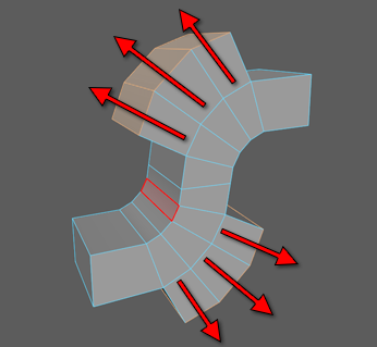

You can also use the Move Tool to move groups of connected components along their average normal using Component Axis Orientation.
For more information, see Transforming multiple components independently.

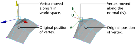

You can also move vertices along their normals using the Move Normal Tool.
To move vertices along their normals using the Move Normal Tool
