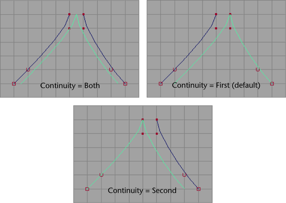

Positional continuity means that the ends of two surfaces meet exactly. The following figure shows a side view of how surfaces are aligned with each Modify Position option (First, Second, and Both). The alignment occurs depending on which surface is selected first (white) and last (green).

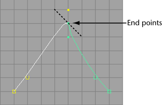

Tangent continuity exists when two surfaces are placed end to end, and the tangents at the endpoints also match. An example side view of aligned surfaces follows:

You can choose the order you want the surface modified. The following tables show what is modified with the different Modify options.
| Modify Position | Surfaces |
First Only the shape of the first surface you select is modified. |
The entire first surface moves so its end boundary coincides with the start boundary of the second surface. Some adjustments are made to the first surface end boundary CVs. |
Second Only the shape of the second surface you select is modified. |
The entire second surface moves so its start boundary coincides with the end boundary of the first surface. Some adjustments are made to the second surface start boundary CVs. |
Both The shapes of both the first and second surfaces you select are modified. |
The entire first and second surfaces move so that the end boundary of the first surface and the start boundary of the second surface coincide. The adjacent boundary CVs move halfway along the line of minimum distance. |

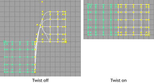

The Reverse and Swap options for surfaces define whether the surfaces have to be reversed and or swapped before performing the alignment (remember, align uses the end of the first surface and the start of the second). The reverse is done in the direction defined by Direction U (on or off) in the Channel Box.
If Twist is turned on, the second surface is also reversed in the opposite direction of Direction U. Turn this on if your aligned surface is twisted.

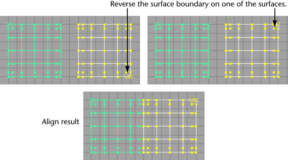

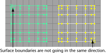

For example, if you align the surfaces and the surface boundaries are going in different directions, the following results.
When you select the surfaces, the align result is twisted. Turn Twist on either from the Attribute Editor or in the Channel Box to correct the problem.
The other alternative is to check the surface U/V direction before you align the surfaces. Use Surfaces > Reverse Direction to reverse the surface directions if necessary.
