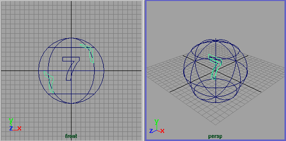

In the following figure, the projection was attempted while the perspective view was active. As you can see, the curve is not projected correctly.

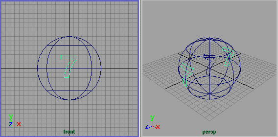

Projecting while the front view is active works because the perpendicular direction of the projection is relative to the surface normals of the front view.

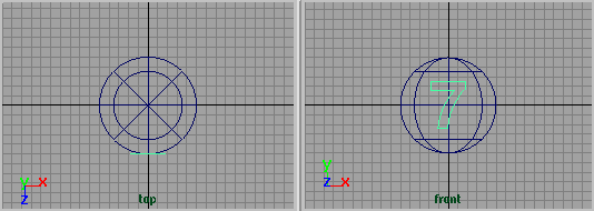

Surface Normal lets you project a curve onto the selected surface in one view and then use the same curve to project onto additional surfaces in any other view. The active view is not important if you project while this option is selected.
If you select Surface Normal, make sure you move the curve to the outside of the surface.
The curve lies on the axis of revolution inside the surface. If the curve is inside the surface, the projection will either take a long time to complete or it will fail.
