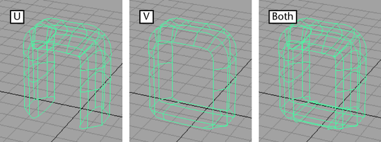

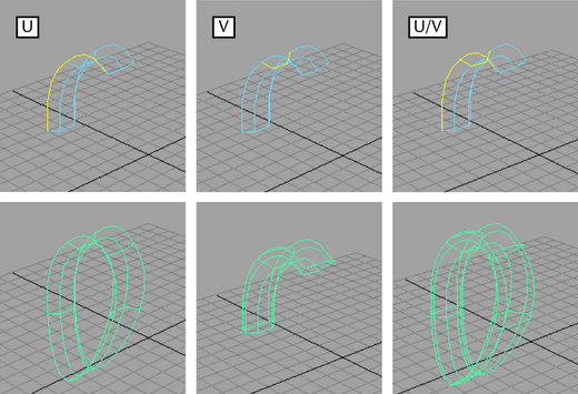

The Surface Direction options, U, V, and Both, let you choose the direction in which a surface is open or periodic. The following figure shows how these options are used to close a beveled curve.

You can select the direction in which you want the surface to be periodic from the options window, or you can click to select isoparms on the surface. When you do this, you override the Surface Direction setting in the options window.
