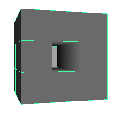

To make a hole in the shape of a second face

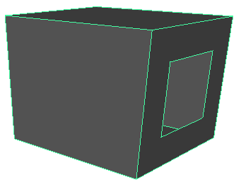

You can also create a hole in a single object by selecting faces on either side.

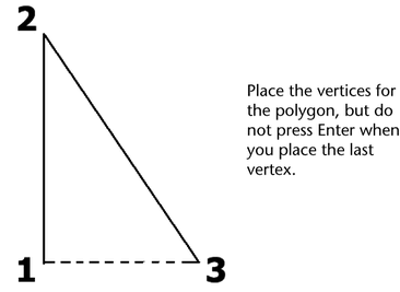

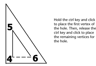

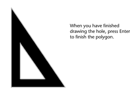

To create a hole in a polygon as you draw it

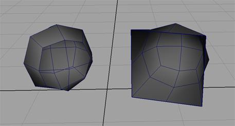

Unlike real holes in the geometry, you can still select and perform operations on invisible faces when in Face selection mode. If you subdivide the mesh (for example, using the Smooth operation), the subdivisions respect that the face is still there.
For example, the image below shows two cubes after being smoothed. The front face on the cube on the left was made invisible prior to the smoothing, while the same face on the cube on the right was deleted.
