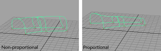

Select Proportional or Non Proportional to choose how to scale the profile curve sweep along the rails.

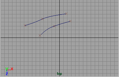

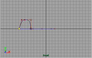

Construct rail curves in the XZ plane. Construct the profile curve so that the internal CVs are at some constant Y. By scaling nonproportionally, the internal CVs of the birail surface also preserve the constant Y as the profile.
