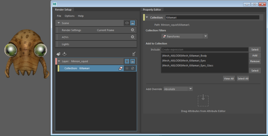

Layers are populated via collections. When you add objects to a collection, only their transform node is included. This determines the objects you see in the viewport when the layer is visible.
In this example, a render layer Minion_squid is populated with the collection Killamari. The Mesh_Killamari body, eyes, and eyes glass transform nodes are added to the collection, and therefore the character's body, eyes, and eyes glass are visible in the viewport.

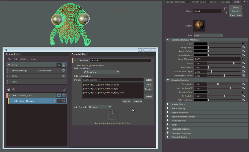

When you create an override on an attribute on the shader; for example, Ambient Color, Maya automatically creates a collection that includes all the shaders assigned to the Mesh_Killamari nodes, as well as the corresponding override. In other words, it is not necessary to manually add the shaders of Mesh_Killamari to the Killamari collection, nor is it necessary to manually create a shaders collection.
Similarly, when you create an override on the shape node, for example, Template, Maya automatically creates a collection that includes all the corresponding shape nodes of Mesh_Killamari, as well as the corresponding override.
