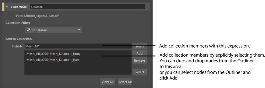

Select a collection and its attributes appear in the Property Editor. You can add nodes to your collection by doing any of the following:
You can add the same node to more than one collection.
Use a wildcard in your expression to include nodes in your collection; for example, building* to include all nodes with names starting with building. All wildcard characters supported by the ls command can also be used in this expression.
By default, only transform nodes that match your expression are included in the collection. For advanced users, you can use the Collection Filters drop-down menu to adjust the collection filter to include other types of nodes in your collection; for example: shaders, shapes, shading engines, sets and so forth. You can even include all nodes, regardless of type, by selecting the All collection filter.
Expressions are case sensitive; for example, *cushion* is not the same as *Cushion*.
In this example, the expression Mesh_K* includes all of Killamari's body, eyes and eyes glass in the collection.

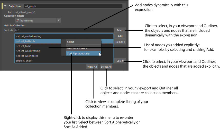

You can add members to your collection statically (by explicitly selecting nodes and adding them) instead of dynamically (using an expression, as described above). To do so, middle-mouse drag and drop nodes from the Outliner to the Property Editor. Alternatively, you can select the nodes in the Outliner and click Add in the Property Editor.
If you have included an expression as well as manually added a list of nodes, your collection will include both the nodes that match your expression and the nodes you list.
You can order this list alphabetically, or in the order in which you added the objects. Right-click the list in the Property Editor and select Sort Alphabetically or Sort As Added.

Click View All in the Property Editor for a listing of your collection members.
Alternatively, you can also click Select All to select the collection members in your scene and in the Outliner.
In addition, separate Select buttons exist for members included via expression and members included via selecting and adding. Use these buttons to verify the collection members added via each of the two methods. See Identify the objects that belong in your collection.
To remove members added via drag and drop, right-click the node (or multiple nodes) in the collection Property Editor and select Remove. You can also select the node and click Remove.
To remove members added via expression, delete the expression.
