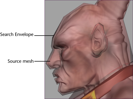

The search envelope is a user-editable piece of geometry that defines the search volume or threshold of the transfer map generation operation.
This attribute sets the size (%) of the target meshes’ search envelope. If you set the Search Envelope to 10, then the size of the envelope will be 10% larger than its target mesh.
You can edit the search envelope’s vertices to fine tune its shape and coverage.

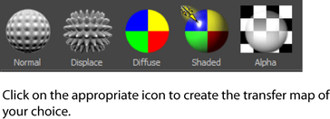

Select a map type from the list of icons available. The section for the selected map type appears. You can create as many maps as you need.

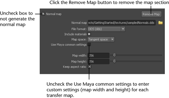

Your settings (for example, the map sections that you have created and checked) are saved with each session of Maya.
Normal maps capture the surface normal information of the source meshes. The texture is sized and positioned depending on the UV parameterization of each mesh.
When on, a normal map is generated. Enter the filename and path to which you want to save the map.

If you plan to create several maps with the same width and height, you can reuse your settings by entering them in the Maya Common Output section of the Transfer Maps window.
If you uncheck this option, the Map width and Map height attributes appear within the Normal Map section of the window. For more information regarding these attributes, see Maya Common Output .

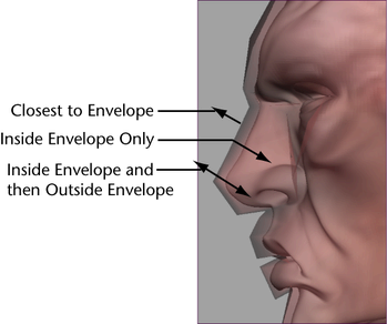

Sets where in relation to the search envelope the target meshes are being looked for.
Search for target meshes outside the envelope.
Search inside and outside the envelope for target meshes.
Search only inside the boundary of the envelope for target meshes.
