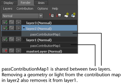

You can create your render pass contribution maps using this menu.
Create a new pass contribution map and associate it with the selected layer.
The submenu provides a list of pass contribution maps available in the scene. Select the desired contribution map to associate it with the current layer.
Duplicate your selected contribution map.
This option indicates which objects belong in the selected pass contribution maps. All objects in the pass contribution map are selected.
Use this option to add the selected objects to the selected pass contribution maps.
Use this option to remove objects from the selected pass contribution maps.
To remove a pass contribution map or multiple pass contribution maps, select the map(s) and then choose this option.
Pass contribution maps that do not have geometries and lights assigned to them are removed with this option.
Opens the Relationship Editor window.
Opens the pass contribution map Attribute Editor.

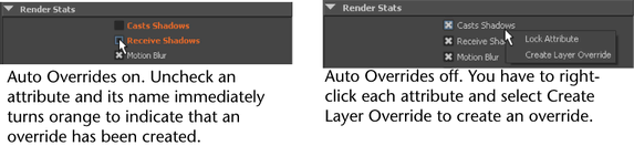

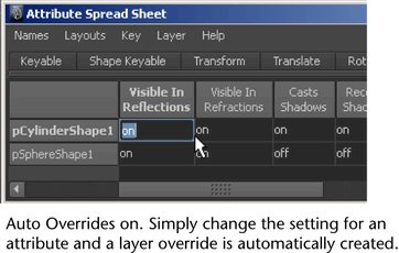

The Auto Overrides option simplifies the workflow for creating layer overrides for attributes such as Casts Shadows, Receive Shadows, and Visible in Reflections.
The Auto Overrides option is applicable to the following attributes:
When the Auto Overrides option is on, you can simply click on each of these attributes and an override will be created for the selected layer. Upon being unchecked, the attribute name immediately turns orange to indicate that a layer override has been created. This eliminates the need to right-click the attribute and select Create Layer Override.
This feature is most useful when there are multiple objects/layers in the scene for which overrides need to be created. This feature simplifies the workflow by eliminating the need to select Create Layer Override.

Create a new empty contribution map for the selected layer.
Create a new contribution map for the current layer containing the selected objects.

The following commands are available when you right-click a render pass contribution map.
Select the pass contribution map name to display its Attribute Editor.
Add or remove objects from both the render layer and the current pass contribution map.
This option indicates which objects belong in the current pass contribution map. All objects in the pass contribution map are selected.
Remove render pass contribution map from the current layer.
Remove all objects from render pass contribution map.
Removes render pass contribution map from all layers.
Sets the pass contribution map as active so that it is respected when render passes are created.
Allows you to add a new render pass to your render pass contribution map. Expand the submenu to choose among one of the available render passes.
Opens the Relationship Editor for removing or adding objects to layers.
