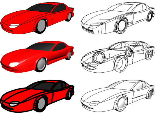

You can use the Maya Vector renderer to create stylized renderings (for example, cartoon, tonal art, line art, hidden line, wireframe) in various bitmap image formats (for example, IFF, TIFF, and so on) or 2D vector formats.
