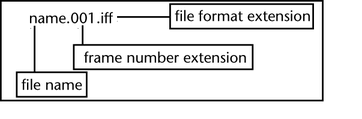

In addition to the rendered image filename tokens discussed above, you can also use the Frame/Animation Ext drop-down list to customize your image name by adding the frame number to your image name. For example, if you choose name#.ext with a Frame padding of 4, and the scene name is MyScene, then the rendered image would be named MyScene0001.iff.
