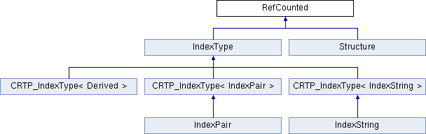

Inheritance diagram for RefCounted:Static Public Member Functions | |

Class implementing standard reference counting.
Simple abstract reference counting class, derive from it and implement the destructor, copy constructor, and assignment operator. Maintains a reference count and indicates deletion is safe when the count drops to zero.
