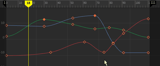

A graphical representation of interpolation between animation keys that you can modify.

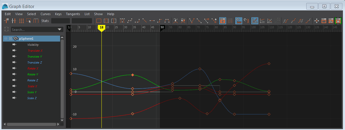

To open the Graph Editor:
Maya's Graph Editor is an updated version of the legacy Maya Graph Editor, giving you a more intuitive approach to manipulating animation curves and keys in your scene.
The following table provides a brief overview of tasks using the Graph Editor:

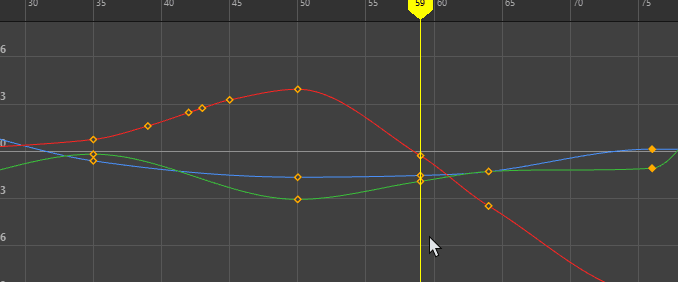

Select a key |
Click the key or drag-select it.
![]() Tip: You have to click
directly on the key. Zoom in (Alt + drag) to increase precision. If you can't select a key this way, it may be a graphics card issue; make sure you have the most up to date drivers.
Insert a key |
Alt + i inserts a key that corresponds to the position of the Current Time Indicator. ![]() |

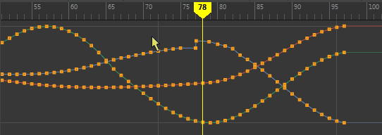

Select and move groups of keys. | Drag a rectangular selection box, then hold
Alt and reposition the selection box.
![]() See also Region Keys tool. |

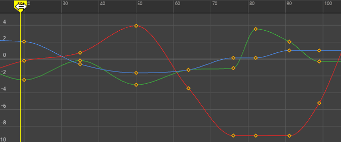

Move multiple keyframes in time without changing the attribute value | Drag-select the keyframes to move. Shift-middle-drag the frames left or right.

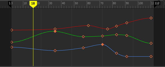

Change views | Absolute view: Press
1
This view is the default. ![]()

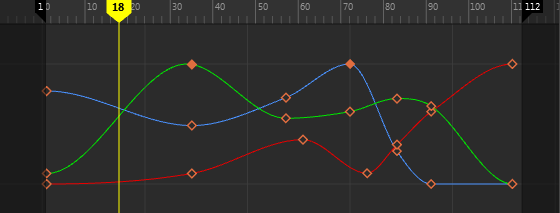

Stacked view: Press
2
Normalized view: press
3
![]() Select to revert back.Note:
Curves are automatically renormalized when you turn on Display Normalized or the active curve list changes. |
