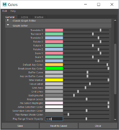

Note: You can customize these and other Graph Editor colors in the Color Settings. (There are separate sections for the Graph Editor and Classic Graph Editor colors.)
You can customize these colors in the Color Settings (there are separate sections for the Graph Editor and Classic Graph Editor colors,) and also in the Graph Editor Change Curve Color options, found in the Graph Editor Edit Menu.
Color settings Graph Editor colors

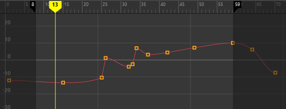

Graph Editor Play Range shades
You can change the default color and opacity of the Playback Range Shade in the Color Settings as well.

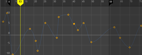

Graph Editor Time Ruler
You can change the default color and opacity of the Time Ruler, as well as Time Ruler numbers and ticks in the Color Settings as well.

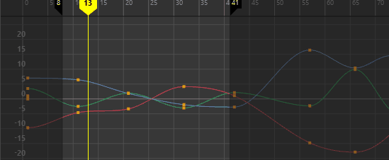

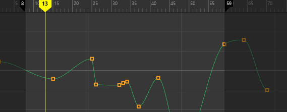

Graph Editor Curve colors
By default, curves are represented in the Graph Editor with colors that reflect which axis the curve represents. You can customize the color for an individual animation curve in the Graph Editor Change Curve Color option, found in the Graph Editor Edit Menu.
Red curves
Red curves indicate animation on the X-axis, whether it be Translation, Rotation, or Scale animation. Red in Maya is used to represent the X-axis.
Green curves
Green curves indicate animation on the Y-axis, whether it be Translation, Rotation, or Scale animation. Green in Maya is used to represent the Y-axis.
Blue curves
Blue curves indicate animation on the Z-axis, whether it be Translation, Rotation, or Scale animation. Blue in Maya is used to represent the Z-axis.

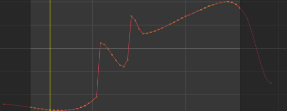

Baked channel
Baking a channel puts keys on every frame of the curve.

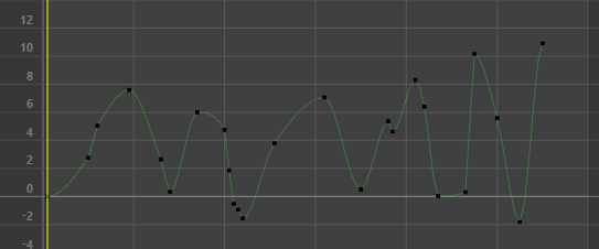

Grey curves
A grey curve with black keys is a curve that is Locked.

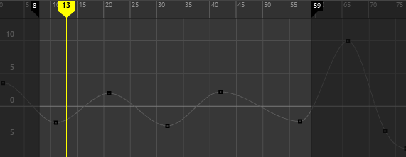

Faded curves
A faded curve with normal keys is a Muted curve or channel.

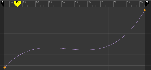

Purple curves
A purple curve is a Timewarp or Speed curve. A Timewarp curve lets you modify (or warp,) animation timing so you can manage the overall sequencing of multiple animation curves in one place, rather than tweaking each translation, rotation, and scaling curve individually. See Create time warping effects for more.

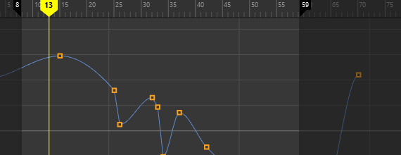

Dimmed curves
Curves that are faded in the Modern Graph Editor Curves are Referenced Curves, which mean that they are linked to animation in a Referenced File. They are not editable by default: this is shown with black (locked) keys.

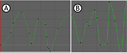

In the Classic Graph Editor, Referenced curves appear as dotted lines with black keys.
Referenced Curve in the Classic Graph Editor: A. Locked, B. Unlocked
