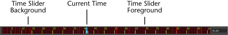

Key ticks
Key Ticks are red (by default) marks in the Time Slider that represent the keys you set for the selected object. Breakdowns are a special type of key displayed as green marks in the Time Slider. See Breakdowns.

Time Slider Colors
You can customize the color settings for the Time Slider to increase visibility, especially for larger timelines.

To change the color of the Current Time Indicator
    Change the Time Slider Current Frame setting. (Click the color tile, then select a new color.)
To change the color of the Time Slider foreground or background
    Change the Time Slider Foreground and Time Slider Background settings.
