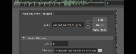

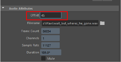

If you want audio file(s) to start playing at a time different from the default of Frame 0 in your scene, click the option box next to the file. The Attribute Editor opens with the settings for the selected audio file.
Enter the frame you want the audio to start in the Attribute EditorOffset field.
Note: If you want to layer multiple audio files and stagger them so they start at different times, see Offset multiple audio tracks in the Time Editor, below. You can also see the Audio Offset settings in the Import Options for instruction on importing audio with offsets.
