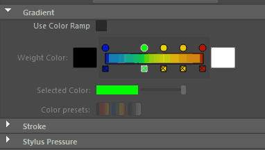

Gradient settings
Use Color Ramp
When on, weight values are represented in color on the mesh. This can make it easier to see small values when painting, and to determine whether a joint is influencing vertices where it should not. For more information on using color ramps, see Set attributes using ramps.
Different Color Ramp types
When Use color ramp is on, you can use the Weight Color ramp and Selected Color options to customize the color ramp. You can also select one of the Color Preset options.
Weight Color
When Use Color Ramp is on, this area lets you edit the color ramp. Click the swatches on either side of the ramp to set colors to represent values of 0 and 1, or select part of the ramp and click the Selected Color swatch to re-set that color.
Selected Color
Click to open the Color Chooser window and set a new color for a selected part of the color ramp. Only available when Use color ramp is on.
Color presets
Select from three pre-defined color ramp options.
