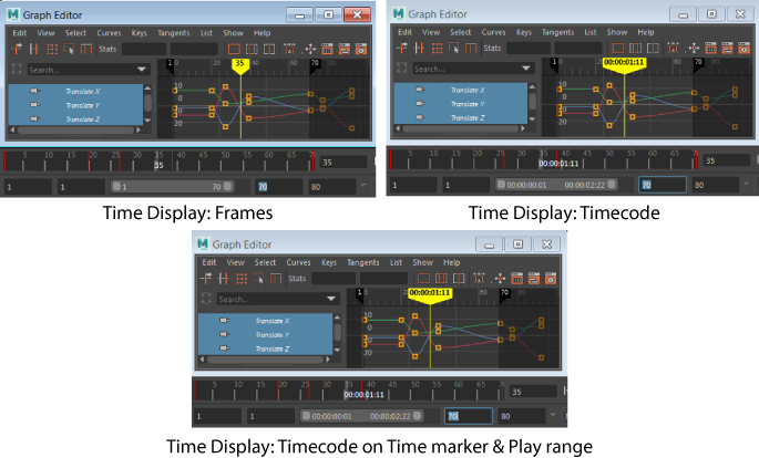

Time Display
Select what format Time information appears on the Time Marker:
  • Frames: Displays frames on all time rulers, current time markers, and input fields which display or accept time.
  • Timecode: Displays video standard timecode on all time rulers, current time markers, and input fields which display or accept time.
  • Timecode and frames on Time Marker: Displays video standard timecode on timemarkers while time rulers shown frames. This is the legacy display when Timecode is set in the in the Time Slider options in the Time Slider Preferences
Note: An asterisk "*" appears next to any number in the Time Slider that has been rounded to the second decimal place to indicate the value has been approximated. This happens sometimes when you switch between Time Code and Frames or if the Snap to Whole Frames option is disabled in the Time Slider preferences.
