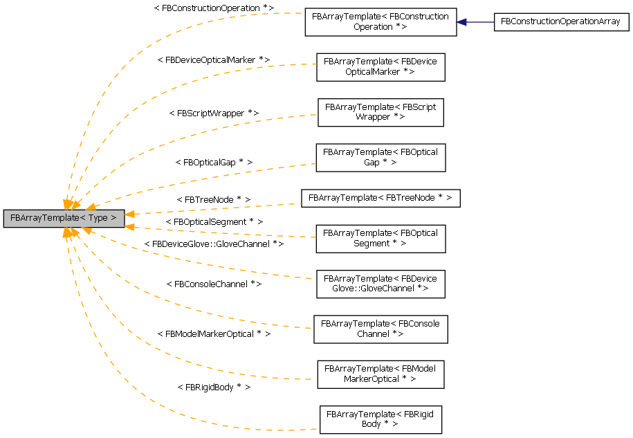

Inheritance diagram for FBArrayTemplate< Type >:

Detailed Description
template<class Type>
class FBArrayTemplate< Type >
Template class to contain an array of items.
Note
This utility template array only support plain old data structure (POD).
