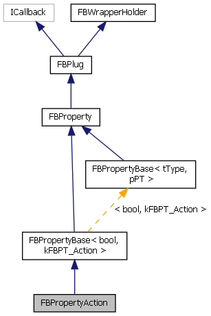

Property: Action Action property to trigger function. More...
#include <fbproperties.h>
Public Member Functions | |
| FBPropertyAction () | |
| Constructor. More... | |
| ~FBPropertyAction () | |
| Destructor. More... | |
| bool | operator() () |
| Overloaded () operator. More... | |
