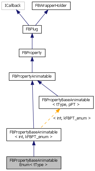

FBPropertyBaseAnimatableEnum< tType > Class Template Reference
Inheritance diagram for FBPropertyBaseAnimatableEnum< tType >:

Detailed Description
template<class tType>
class FBPropertyBaseAnimatableEnum< tType >
Definition at line 1799 of file fbproperties.h.
