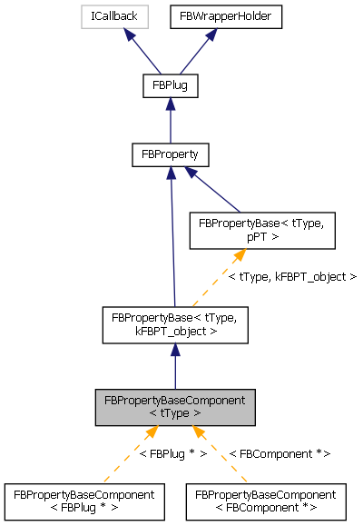

Inheritance diagram for FBPropertyBaseComponent< tType >:
