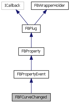

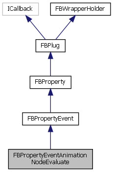

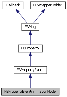

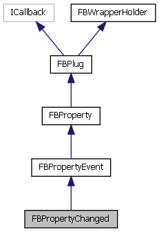

PropertyEvent: Event when a property is modified, to be used with the FBFCurveEventManager.
Definition at line 1404 of file fbdata.h.
