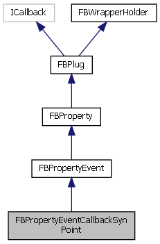

PropertyEvent: Callback at synchronization point (for kFBGlobalEvalCallbackSyn) More...
#include <fbevaluatemanager.h>
