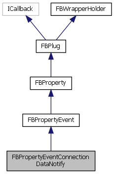

PropertyEvent: Global ConnectionDataNotify event. More...
#include <fbproperties.h>
