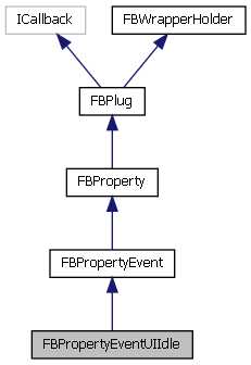

PropertyEvent: UI idle event.
Definition at line 565 of file fbproperties.h.
virtual |
Add/Remove a callback.
| pOwner | Callback owner. |
| pHandler | Callback handler. |
Reimplemented from FBPropertyEvent.
virtual |
