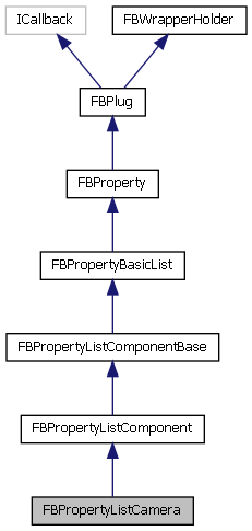

PropertyList: Camera More...
#include <fbcamera.h>
Public Member Functions | |
| FBCamera * | operator[] (int pIndex) |
Get the model at pIndex. More... | |
Public Member Functions inherited from FBPropertyListComponent | |
| virtual FBComponent * | GetAt (int pIndex) |
| Get the Component at pIndex. More... | |
Definition at line 442 of file fbcamera.h.
| FBCamera* operator[] | ( | int | pIndex | ) |
| pIndex | Index of camera to get. |
pIndex.
