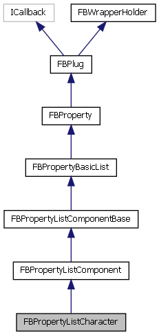

PropertyList: Character. More...
#include <fbcharacter.h>
Public Member Functions | |
| FBCharacter * | operator[] (int pIndex) |
| Get the Character at pIndex. More... | |
| virtual int | Duplicate (int pIndex) |
| Duplicate a Character. More... | |
