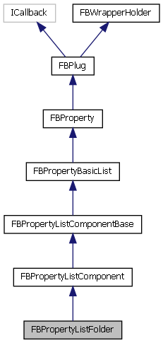

PropertyList: Folder More...
#include <fbfolder.h>
Public Member Functions | |
| FBFolder * | operator[] (int pIndex) |
| Get the component at pIndex. More... | |
Definition at line 61 of file fbfolder.h.
| FBFolder* operator[] | ( | int | pIndex | ) |
| pIndex | Index of component to get. |
