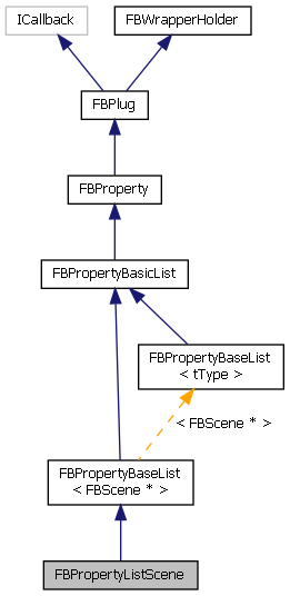

Inheritance diagram for FBPropertyListScene:
