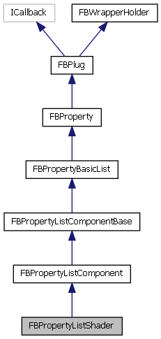

PropertyList: Shader More...
#include <fbshader.h>
Public Member Functions | |
| FBShader * | operator[] (int pIndex) |
| Get the shader from list at pIndex. More... | |
Definition at line 690 of file fbshader.h.
| FBShader* operator[] | ( | int | pIndex | ) |
| pIndex | Index to get shader at. |
