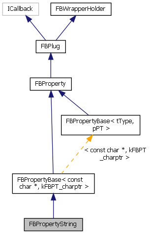

Property class: const char * (String). More...
#include <fbproperties.h>
Definition at line 1290 of file fbproperties.h.
inline |
Overloaded cast to tType operator.
Get the value of the current object using Get function.
Definition at line 1306 of file fbproperties.h.
inline |
Overloaded = operator.
Set the value of the current object using the Set function.
| pValue | Value to set for object. |
Definition at line 1299 of file fbproperties.h.
overridevirtual |
Set the value of the internal property.
| pValue | Value to set to internal property. |
Reimplemented from FBPropertyBase< const char *, kFBPT_charptr >.
