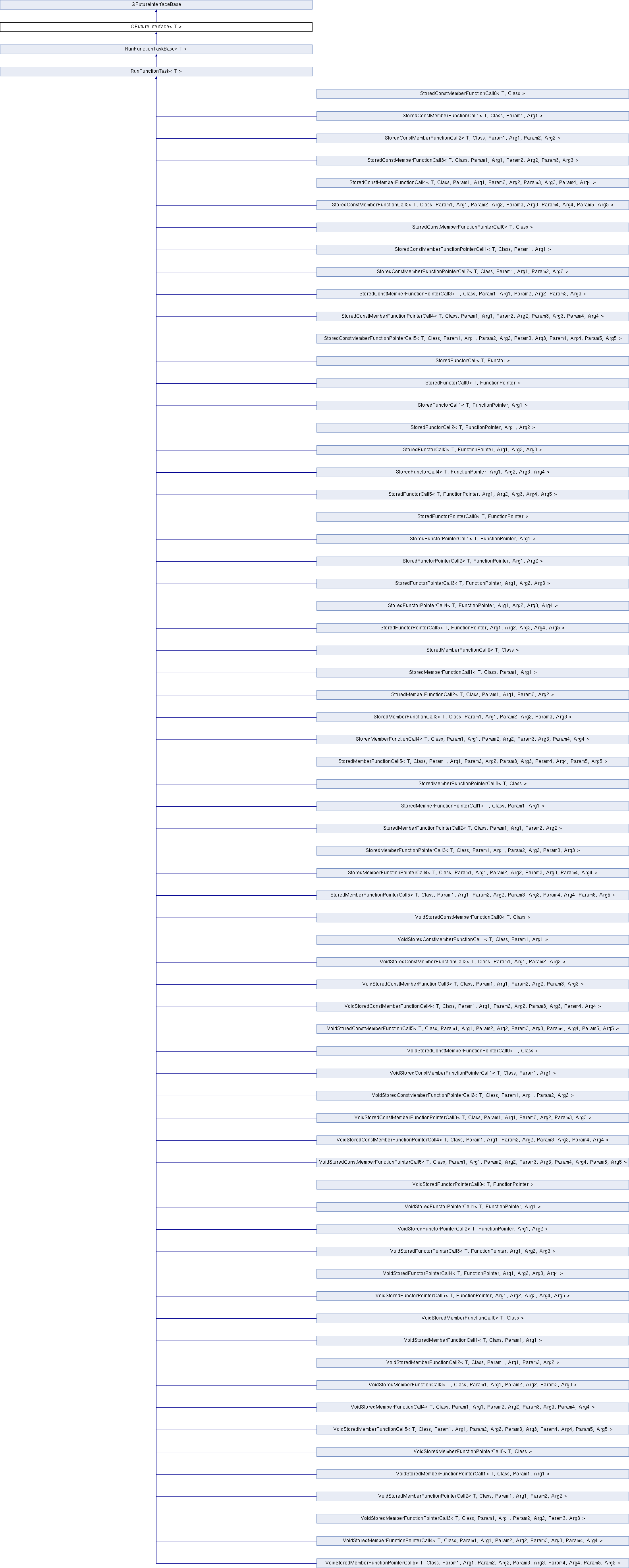

+ Inheritance diagram for QFutureInterface< T >:
