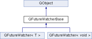

+ Inheritance diagram for QFutureWatcherBase:
