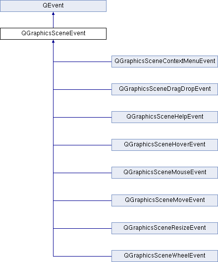

+ Inheritance diagram for QGraphicsSceneEvent:
